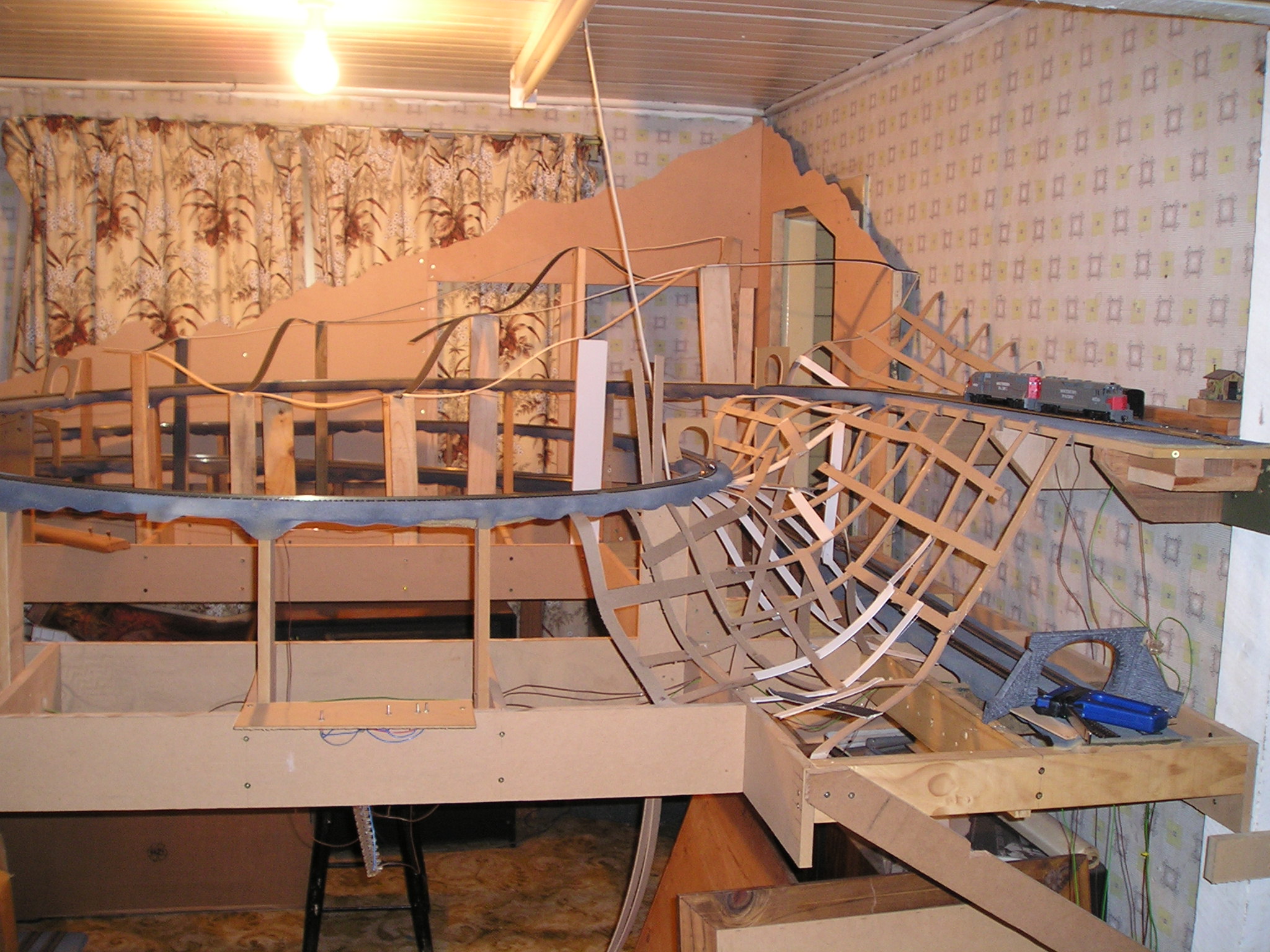

For Tunnels I used a very similar method.
If it is against the backdrop or in a corner I use stiff cardboard cut into 20mm wide strips & eith hot glue or staple to the baseboard & backdrop. If not attached at rear I cut 20mm-30mm pieces of wood & hot glue or PVA them at the rear of the mt or tunnel & then use cardboard strips from piece to piece& then from the back to the base board.
Next step is to screw up the newspaper again & follow the same steps as in the previous post.
I'll have a hunt through my photos & see if there is a good shot of this.
On my last layout I started & 8ft x 8ft mountain that went from waist height to the ceiling.
Apr 30th, '09, 11:52
Post Re: Scenery for Your Layout
Here is a shot of the wooden uprights & cardboard strips. The layout is Railroad HO 1:87 scale.
Just to give you an idea of the scale of the mountain. :P
